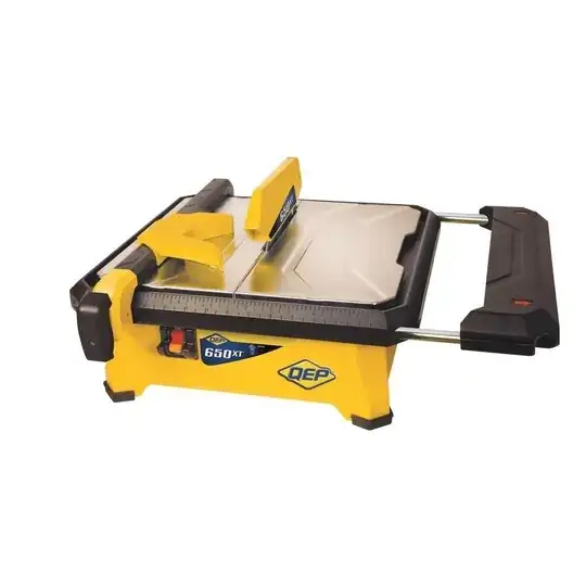

The best approach is a tile saw that can make small precise cuts along the length of a tile. It is a power tool like a table saw but uses a diamond impregnated blade and a water cooling system. They can be bought or rented. tile saw

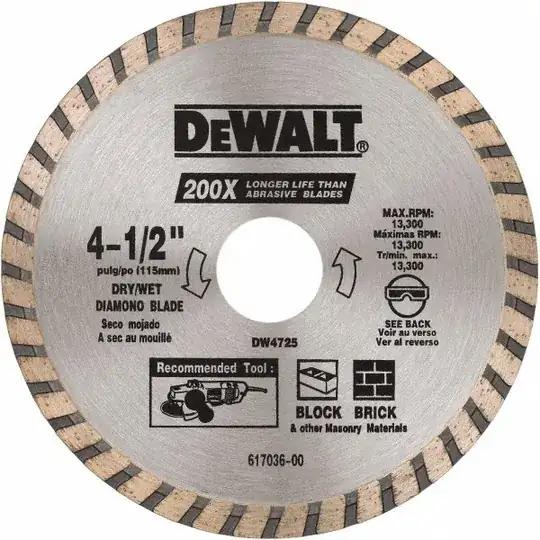

Dry Diamond blade
So I bought one of these dry diamond blades for an angle grinder - if you don't own an angle grinder, this might just be one of the few times I'd say that the cheapest knock-off you can find with a warranty that's slightly longer than your project will take would be appropriate - personally, I had one already. Eye protection, dust mask, work outside or somewhere with massive dust collection. As compared to the wet tile saw, no built in fence, (I was able to set up wood to clamp tiles and act as a fence when needed) not wet so there's dust, much less expensive. As compared to the nippers, no comparison, this just works. I was even able to miter-cut some tile to make up for not being able to find bull-nose for 50 year old tile I was reusing.
Image is an example, not an endorsement. A dry or dry/wet blade is what you want for dry cutting - a wet (only) diamond blade will not be happy if used dry.

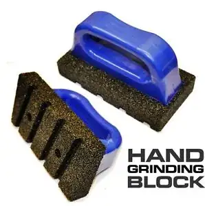

However if you literally have only a couple of tiles you need trimmed, bringing them to a tile shop might be the best option - pay them a couple of bucks to trim them for you. Or the cheapest (if a bit slow) tool would probably be one of these silicon carbide rubbing blocks:
rubbing block
which you could just grind down the edge with.
