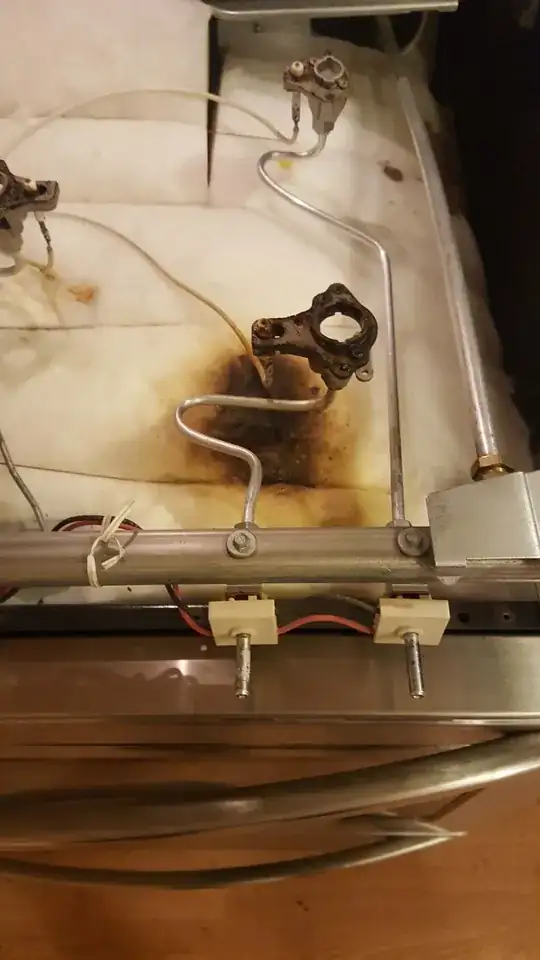

I accidentally spilled some oil on the stove which seeped down below the top. The oil is now in the insulating blanket that surrounds the oven and caught fire while a burner was on. Can I buy new insulating material, cut out this patch and replace it? Any help appreciated.
edit: can I use this product to patch it?
https://www.amazon.com/Ceramic-Insulation-Ceramics-CM-Ceramics-Instructions/dp/B015GD0QCW/ref=pd_cp_60_2?_encoding=UTF8&psc=1&refRID=G3MA4QEVGWZ0CFCYCDKX
You'll have to find the right material, as this is certainly high-temperature insulation and you don't want to have a new fire. Where to find that insulation is off-topic here, but once it's in hand it doesn't look like replacing that small section will be too bad a job (certainly less work than you've already put in).
