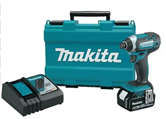

Get an impact driver and you can drive a four-inch screw into just about any hardwood without a pilot hole. Stay away from anything done by hand or with electricity. "electric screwdriver?"
My choice is the cordless lithium-ion battery-powered impact driver by Makita: makita impact driver
This is the best "if-you-could-only-have-one" screwing device ever manufactured.
Through a combination of bit rotation and concussive impacts to the screw, an impact driver easily drives every type of screw or lag bolt into very dense materials with ease. Impact drivers usually deliver 2-3 times more torque than a cordless drill and in a recent Popular Mechanics test, an 18V cordless impact driver drove 138 3-inch lag bolts into solid wood on a single charge.
All that said, if you can't get your hands on an impact driver, a properly-sized pilot hole is the key for all scenarios. Including situations where you have the impact driver. You should never have to use such incredible force that it can't be done easily with whatever device you are using - even if by hand with a regular screwdriver.
