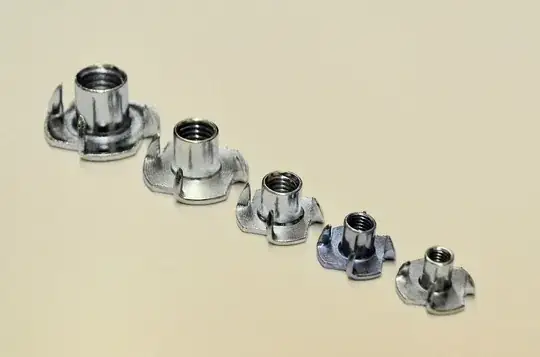

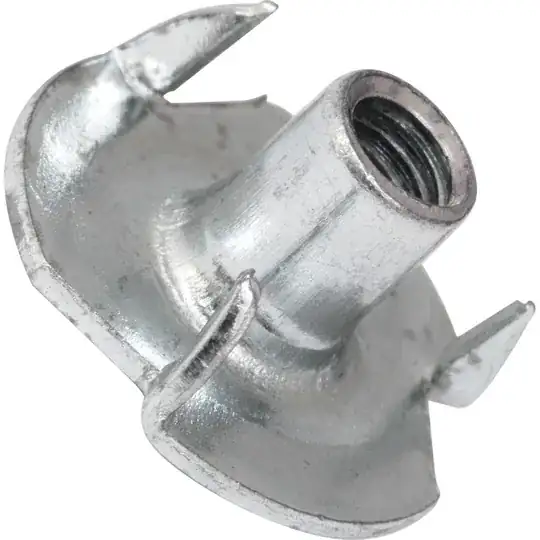

You are looking for t-nuts
These would work with your removable eye-bolts

As you've allowed for the option of using eyebolts, the receiving portion of that system is called a T-nut, and would require only an appropriately sized hole in the floor board, with the t-nut tapped in from below.
I would also suggest to recess the upper portion of the hole to enable you to place a binder bolt or similarly-headed bolt in the opening when not in use. This would prevent debris from entering the hole and clogging the threads. A slot-head type is going to provide the best option for later removal. Hex head and slotted head bolts can collect the same debris, reducing the value of such a fastener. You can use a forstner bit for a bolt with a flat underside or use an ordinary bit if the fill-bolt has a countersunk head.

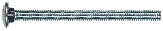

Get a long carriage bolt.
carriage bolt
Drill a hole.
Maybe chisel a tiny square so the head can sit nearly flush. (Skip this step if you're lazy or don't have fingernails to pick at the head of the bolt when it's flush.)
Drop the bolt through and put a nut on the end.
Have an adult beverage.
