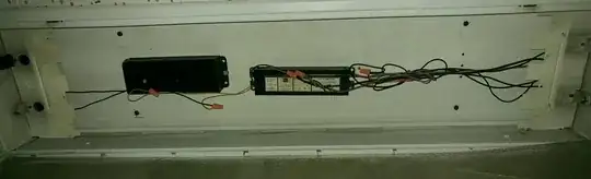

EDIT: I've added a picture of my fixture... It looks like there was an old ballast in there, possibly magnetic, and they did the same thing: cut it out electrically but leave it mounted. I'd be quite happy to remove both.

First, that fixture looks permanently hardwired. If so, you'll want to add a ballast disconnect. Code requires it, unless you argue that the fixture is now ballastless. But it's so darn convenient that I add them immediately upon starting work, and then, turn the power back on!
Cutting the wires off at the ballast is someting I only do to ballasts which are dead. It's already been wirenutted from the previous ballast swap, I would just do it at the wire nuts.
Generally, ballast instructions are generic and simplified, try to come up with a universal instruction and you can see where it's hard. Potential reasons for the "leave the ballast" instruction include:
  • different ballasts require disposal in different ways, and it's complicated and they don't want to open that can of worms
  • in particular, they don't want to scare the hell out of people with talk of PCBs
  • it may greatly reduce the weight of the fixture, with unknown consequences
  • it will shift the fixture's balance point, relevant to chain-hung fixtures
  • removing the ballast may leave holes on the fixture uncovered, which Code would disallow
  • in some bad installations, the screws holding the ballast also help hold the fixture to the ceiling.
