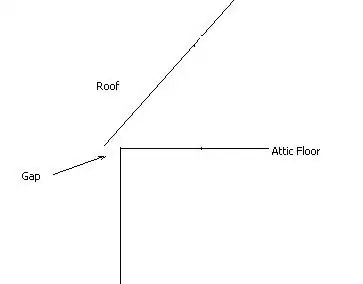

We bought a new house last year. Going up to the loft we noticed there is a considerable gap (5-6 cm) between the roof and the wall, like this:
Is it supposed to be like that?
It's freezing up there but I'm more concerned about animals entering the house.

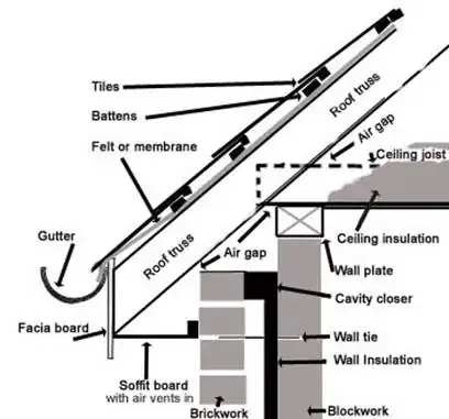

There needs to be air circulation in unheated space to prevent condensation causing rot.

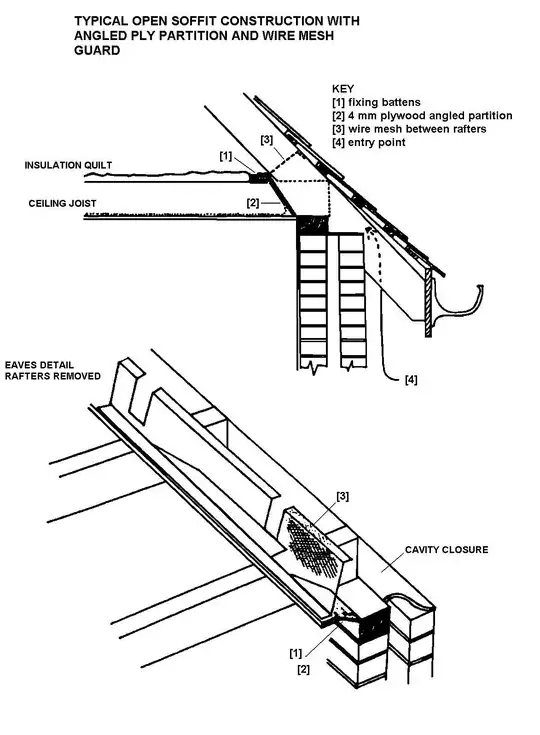

I found fixing wire-mesh externally to any small gaps at the top of the walls keeps unwelcome types of animal out. You could instead apply this internally.
The Royal Society for the Protection of Birds encourage builders to make provision so that critters can enter your roof to nest.
Note the wire-mesh guard to prevent them getting to areas where they would be unwelcome.

That area is supposed to be open for venting the roof. However it should be covered with a material made of aluminum or vinyl with a type of screen to allow air to enter but keep small animals and rodents out. To get an idea of what I am talking about GOOGLE "soffit and fascia",and you will see typical installations. This roof area should be cold unless you are using some of this for living space. If the area under the roof is just for storage or nothing then you should have adequate insulation over the conditioned space below. Are you sure the contractor has finished the building of your home. I would check other houses near you to see if theirs is like yours or covered. The contractor may have forgotten to finish the job.
