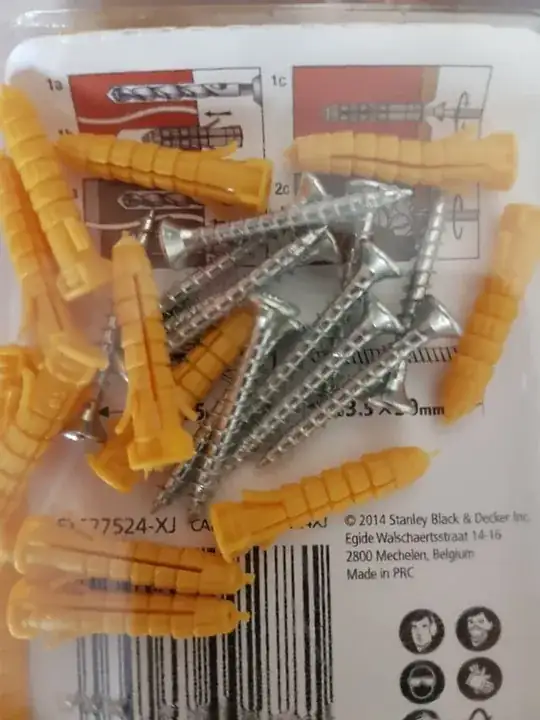

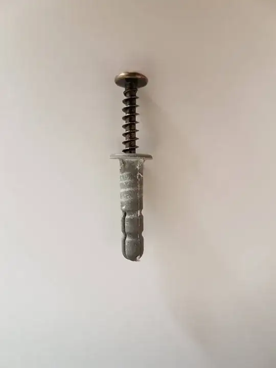

I recently installed a curtain rod into drywall with the default screw anchor provided with rails (top picture). My partner thinks that the rods aren't sufficiently stable and wants me to do the work again with better looking screw anchors (second picture).
How can I convince them that the setup is stable? I already demonstrated by pulling on the rail. Any other ideas?

Personally, for anchoring in wallboard, I prefer "zip-its", also known as auger anchors, tornados, and even wall-drillers, based on their part number at a certain manufacturer.
By the way, the plastic sleeve anchors that your partner likes are, I believe, better suited for cinder-block and concrete. In plaster-board, it's zip-its or toggle-bolts that you really want.

You need a fastener which opens out on the backside of the drywall but it depends on the construction of the house. Whats behind the drywall? Timber frame or masonry?
I see you're in the UK, so it's likely the drywall is stuck to blockwork using an adhesive (dot and dab). In that case the second fixings would be better as it would get into the wall itself.
Drywall doesn't have good holding power unless you can get behind it using a fastener which opens out (not possible on 'dot and dab') or through it and into the wall.
NOTE: Where you have drywall bonded to masonry, use a 7mm or brown rawlplug and drill a hole deep enough to ensure the whole of the brown plug is in the masonry.
Typically this means a 8g or preferably a 10g screw at least 65mm or 2 /12" long.
