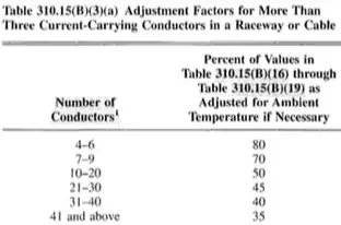

In one box, you propose twelve 12/2 cables in a single conduit. That is 24 conductors (grounds don't count). Because you have so many, NEC rule 310.15(B)3 requires you de-rate the conductors at 45% (per table 310.15B3A)

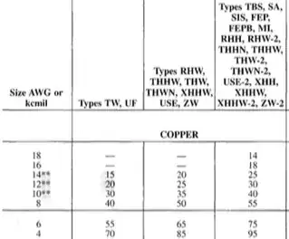

and per whatever type of cable you are in fact using on table 310.15B16:
For instance if you aim to run 20A, and use THWN-2 or USE-2, 10 AWG wire is 40A x 45% = 18A -- not enough, you must go to 8 AWG wire.
If you're asking "why haven't I heard of this before", it's because the way the numbers work out on 310.15B, the de-rate rules generally don't bother 15-20A circuits with 9 or fewer conductors. It may be a factor for 30A circuits or larger. Grounds are not conductors, and neutrals are not counted in 120/240V or MWBC circuits, since they only carry imbalance current. So any circuit in single-phase or split-phase tends to count as 2 conductors, allowing 4 circuits.

Since your boxes are outdoors, everything needs to be listed for wet locations. You cannot use NM cable. You would need cable listed for outdoor use, e.g. USE-2. If you use UF or USE cable, go back to 310.15B16 because there's an additional derate, for instance necessitating 6 AWG if using UF.
