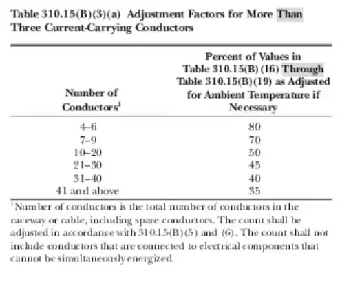

If you plan to use conduit to run both sets of SE cables, you need to derate them, unless the conduit is able to enforce proper spacing (which it likely isn't). For two sets of 3-wire cables (four with ground), that is 4 conductors (neutrals aren't counted since they only carry imbalance current in a split-phase cable). In that case, your derating is to 80% of wire ampacity for its temperature rating.
Conduit Derating Table
In this case, 2GA copper wire is appropriate because it services 130A, which derates to 104A. If you have them running separately, then you can use up to 4GA. See this table.
