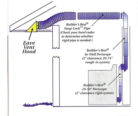

As others have said you don't want to let humid air into your attic space. You will not only get mold as others have mentioned, but the moisture will reduce the effectiveness of the insulation in your attic.
While I understand not wanting to have a vent on your roof, I would recommend either getting a low unobtrusive roof vent on the back slope of the roof or possible putting a vent out the eave or wall.
here is an example showing a dryer vent
