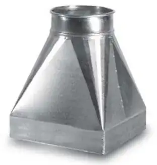

In remodeling my bathroom I had to convert a 6"x6" square duct underneath the floor joists in the basement to flex so I can get around my new toiler drain. I cannot for the life of me find a 6"x6" square to 6" round transition anywhere.
Do I need to fabricate one myself? I don't know what to do.

They do exist. Best bet is probably to contact a local sheet metal shop, if they don't have one they can build one. Expect this to cost in the tens of dollars range.

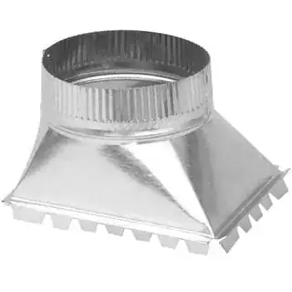

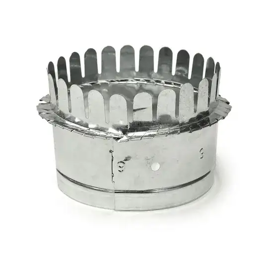

You could potentially cap the end, and then use a round duct takeoff. The downside is it will restrict flow to the vent because of the abrupt end and sharp angles internally.
There's another type of side takeoff that is rectangular, and if you can find one you could potentially modify it yourself using a couple strategic cuts and copious amounts of foil tape.

You'd just cap the square duct and install a takeoff in the cap. It may be difficult to find a hemmed end cap in 6x6, but as you can imagine it would be trivial to fabricate a simple wraparound cap.
