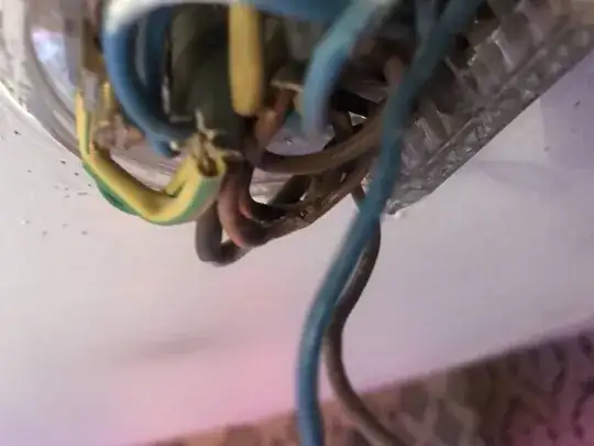

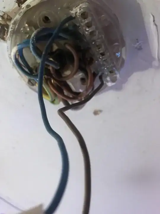

Edit: I think I may have found a problem! I was taking some photos for you and it looks like one of the live wires is melted. I'll attach the photos for you. Please note I did not install the ceiling roses. They were there when I moved in. I just put my light fittings on them. They look quite old and it may be hard for you to see because it seems quite "cramped" in there.
If the live wire is indeed melted does this mean the light is too powerful and has overloaded it? I'm guessing this is going to need to be replaced now?

You have probably mis-wired the ceiling rose. One of the wires from the switch loop will not be what its colour suggests.

Since your breaker is tripped regardless of the switch position, you probably have something other than the obvious error that occurs when the tape is missing.

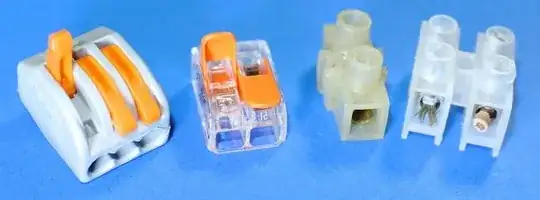

You should not have trouble connecting three or four earth wires to the earth terminal. You can use a connector block if that makes it easier but I believe they must be enclosed in a junction box or in the ceiling rose. There isn't much spare room in a ceiling rose.
The ones on the right are the traditional ones used in the UK, a lighting circuit uses the ones rated 5A. The connectors to the left are Wago 222 and 221 connectors - they make it easier to connect multiple wires together - the leftmost one connects three wires together. There are 2,3 or 5-position versions of each. Wago also make push-in connectors (273 and 773 series) for various numbers of solid-core wires (not stranded). Other manufacturers like Ideal also make them. You can buy these from screwfix and other suppliers.
