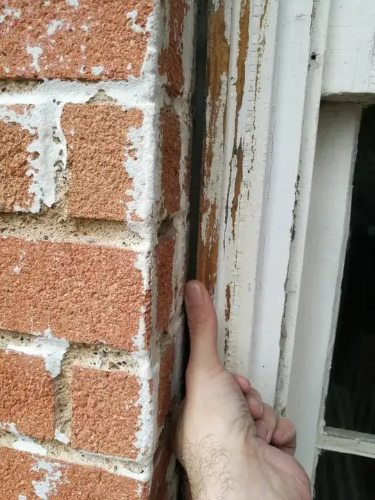

I'm renovating the windows of my 1936 house. Doing the first window and I notice there's a big gap between the window frame and the wall and I was wondering the best way to fill it in so I can caulk it.
I bought a 1/2 inch backer rod, and that seems the right size, HOWEVER, the hole is really deep and gets a lot wider about 1/2 inch in. This means the backer rod keeps falling through the gap when I try to install it.
Is there something else I can use to fill the gap or should I put something behind the backer rod to stop it falling through?

Here's a picture of the gap: gap next to window

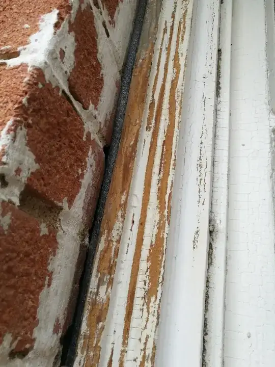

And here's a picture of the gap with a backer rod 'falling through' the gap where it moves around freely:
falling through gap

If I were you I'd try this
  1. Fill the gap with expanding foam. Give it a full day to cure (it expands so doing it too soon will potentially leave it uneven) and cut any bubbles off so it's flush
  2. Buy some really good outdoor (oil based) caulk. The local big box sells something called Quad but if that's not available you can probably find something similar in grade. Caulk over the joint (1/2 inch is about the limit so be liberal). That will seal the window and protect the foam.

I like the idea of using foam to fill the gaps, it will insulate the void and provide a support for the backer rod. However, everything depends on getting the foam at the correct depth: too shallow and the backer rod will still fall back into the void...too much fill and the backer rod AND caulking will not fit.
So, be sure to mark the depth required and practice with the foam on a sample board to see how much you can fill, how much the foam will continue to expand and where it stops for the correct depth.
A word of caution, if the window is old, the frame could tend to twist and move out of alignment when the foam is applied to one-half of the window frame. How sturdy is the window frame?
Also, a backer rod is required, you can't just caulk back to the foam. A backer rod is actually a releasing agent so the caulking will stick to the two materials on the sides (in your case, brick and wood frame) and not to the material behind the caulking. DO NOT OVER FILL. It's not how much caulking you can get in the joint, but rather the proper depth. Most people fill too deep. Most manufacturers recommend a ratio of 3:1. That is to say, 3 wide and 1 deep. This allows the caulking to expand and contract and still stay adhered to the sides. So, if the joint is 3/4" wide, do not fill any deeper than 1/4".
By the way, to me, caulking and sealant are different. Latex caulking is paintable, but dries out over time. Silicone sealant is more flexible (better for locations with movement due to thermal issues, etc.) but can't be painted...as easily.) I doubt if there's a lot of movement between these two materials.
