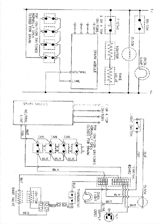

Courtesy of a Google image search, I found the wiring diagram for your stove (see below).
It shows that your stove-top burners are lit by spark ignitors and that your oven is also run by an electric ignition system. It's most likely that the oven is done with a hot coil resistor. If you look under the oven, you'll see it glowing while you've got a rolling flame next to it.
Just in case somebody does have one that has a pilot light, the complicated part is that pilot light systems come with safety valves. If the flame is out then the gas valve will close because the thermocouple / thermopile won't be generating any electricity to hold it open. You need to find the system that allows you to let gas flow without the flame and hold it open for a few seconds after the flame has started.
stove electronics diagram.
