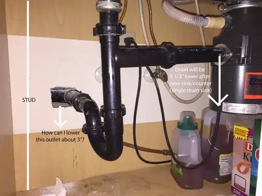

Similar to many others, I'm installing a new sink that is significantly deeper than the one it is replacing. Due to added sink depth and the location the builder chose to install the original drain - I believe I need to lower the drain so that the waste can properly drain.
After the new counter top, undermount 10" deep sink, and garbage disposal, I've determined that the garbage disposal drain will be about 1/2" below the center of the waste drain.
I've determined that the drain is a dirty arm (horizontal style) drain instead of a more traditional trap drain (vertical style).
How would one go about lowering the drain 3" or so specifically with this dirty arm setup? Tearing into the wall under this cabinet is not a problem, but access to the left of the cabinet where it appears the sanitary tee is would be a significant challenge.

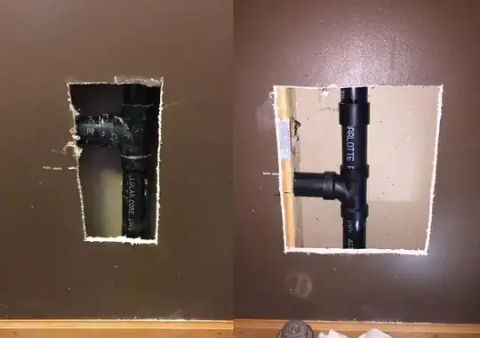

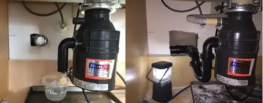

I ended up following Alaska Man's advice and lowered the sanitary tee. After installing the new sink and the disposal, it was obvious that my only option was to take the sanitary tee route. The good news was that I did have access to the other side of the wall so getting at the tee was simple. The unfortunate news was that I really only needed to lower the DWV about an inch.
Here is what my disposal looked like after install - showing the DWV too high by just a bit. The after shows how far I lowered the DWV. Disposal too low
On the other side of the wall, this is where I lowered the sanitary tee about 3 inches total. Sanitary tee

You can use the shortest possible tailpiece on the drain basket and shortest possible section of pipe that is below where the disposal pipe comes in and slips into the trap. (There may be a trap that is not quite as deep as the one you have.)
If that does not get you there then lowering the sanitary tee or shallower sink.
You can not move the waste drain down without moving the san tee. You would need to open the wall cut the drain/vent and move the sanitary tee down and then drill new holes in the studs for the dirty arm.
Or possible turn the san tee so it comes straight out of the wall and then plumb to it without messing with studs.
