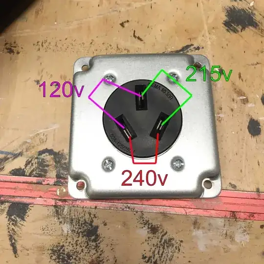

Buddy moved into a new shop and he called me to wire in a 240 plug into a closed off drop. He's heard the previous tenant was probably running a big air compressor or welder. So I wired in an outlet with the 3 wires that were in there, a black and 2 blue. Here's the resulting voltage:
Outlet
After reading these values I figured I screwed up, so I removed the plug and put everything back to how I found it. However, there was another 240v plug in the shop that was already there so I decided to test it and it read the same values.
Violet and red make sense, but green seems impossible??
How is this possible? Is this normal? Was the previous tenant hooking up some non-standard machinery?
EDIT: Continuity between the 3 sockets is infinity, there's no short, the plug seems good. The black wire was attached to the vertical slit (where violet and green meet). Black wire had a very low resistance to the conduit so I would say it's "safe" to assume that's the common rail and tied to ground as it should be. The coloring would also suggest this.

Wrong socket! Wrong socket! Wrong socket!
That obsolete, dangerous NEMA 10 socket is bad news anywhere you see it. You wired this? Never use a NEMA 10 socket ever again. It should not have been sold to you, and make them take it back. It is illegal except for exact replacement of a broken one.

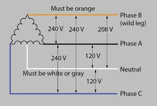

That is wild-leg delta. A perfectly plausible thing to see in a commercial shop. You can see where, by grabbing the correct 2-3 wires, it can supply a variety of voltages including 120/240 split-phase (a-n-c). By law, the wild leg (208 from neutral) must be colored or taped orange.
NEMA 10 connectors are illegal** for new work and have been for some time, they are only legal and sold for replacing broken ones already installed. It has been fully replaced by NEMA 14, which is the same thing with a ground, or NEMA 6 if you don't need neutral. Any of them would grab phases A and C in this drawing.
It looks to me like they grabbed the wild leg by mistake. This would happen if they have a 3-phase service panel and they put the 2-pole breaker in the wrong breaker position (because they don't know what they were doing).
