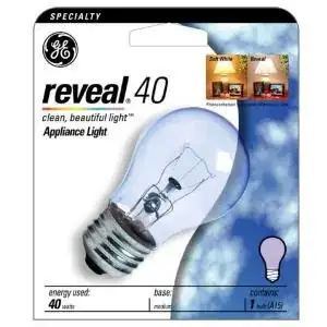

What you are looking for is a 40A15 Appliance Rated Lamp. If you can find 130V buy it, but the lamp does not stay on long enough to really matter. Believe or not it's the same as what is in your refrigerator. I did a quick search and this is what the Home Depot says (I don't work for them, actually they are the competition, kind of):
40A15 Appiance Lamp
The GE Reveal 40-Watt Appliance A15 Light Bulb uses neodymium glass to filter out dull yellow rays for enhanced, vivid results. The bulb is an ideal choice for use in household appliances like microwaves, refrigerators and ovens.
Light output: 320 lumens
Energy used: 40 watts
Life hours: 1,000 hours
