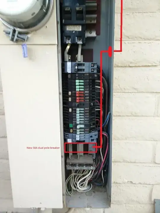

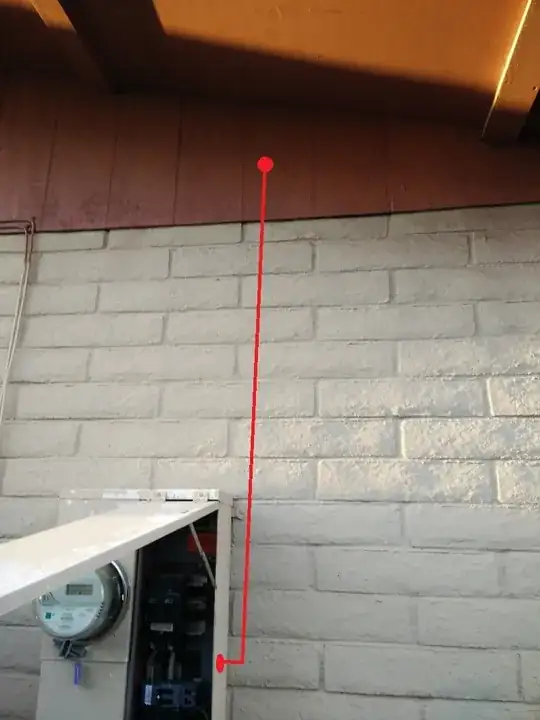

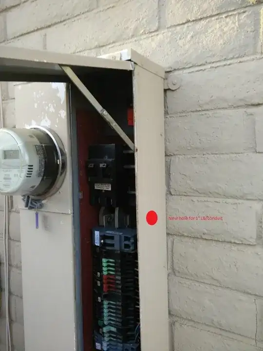

I'm planning on running a 6/3 feeder cable from my main panel to the garage for a small 50A subpanel and am unsure of how to plumb the new cable to the main panel. All of the knockouts are on the bottom of the box, and I want to run some conduit from the panel to the attic along the exterior wall. Rather than adding a couple of elbows in order to run the conduit from the attic to the knockout on the bottom of the box, can I drill a new hole in the side of the panel, near the top for the 1" conduit? I imagine I would need to use an LB here and at the attic entrance?
Here's what I am thinking:

Go out the bottom, otherwise the hole or any flaw in the conduit will bring water, rust and failure into your box.
Use two conduit bodies to make your 180 degree turn. You can do this pretty tight to the box surface if you really want to. Do not strap the conduit to the box, strap it to the wall.
Use THWN-2 wire in the cable. This is rated for outdoor wet locations like this location. Use stranded, you sure don't want to pig-wrestle solid #6 (least of all 4 of them in a cable!)... and stranded will make the bends easily and pull decently. If you don't want to buy 4 colors of wire, buy white - shuck it for ground and put tape on it for hot.
Why white, by the way? Because of the rules applicable to re-marking wires smaller than 4 AWG. You cannot re-mark any color of wire to be ground, it must be green, green/yellow, or bare. You cannot re-mark any colored wire to be neutral - it must be natively white or gray. You can re-mark a white or gray to be a hot, that is the only re-marking allowed (it's intended for switch loops). Admittedly, shucking a stranded wire for ground may not work - but they sell single bare solid ground wire at modest cost.
