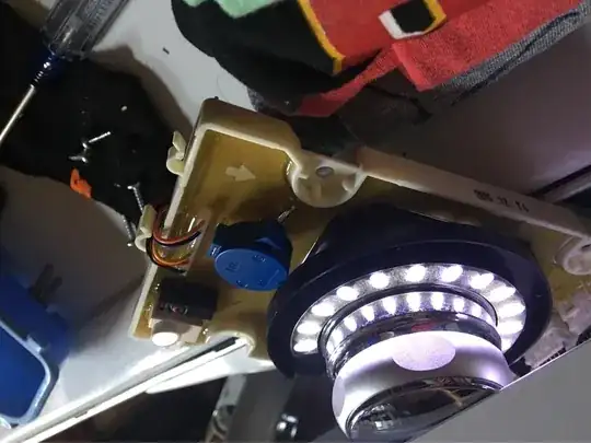

Manufacture mentioned there is no way to silence sound.
Inspired by Haimg's advice, I disconnected one of pins from the speaker module off of the components board.
see image

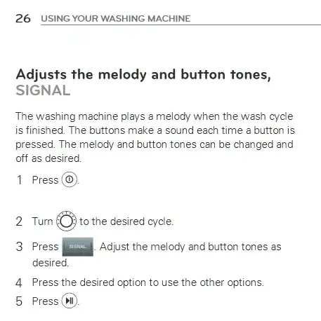

Strangely, page 26 of the manual mentioned in the question says the following:
Adjusts the melody and button tones, SIGNAL
Does that not work, or only apply to some subset of this model? Maybe there is some trick to get it right (sometimes these translated messages lack certain clarity). I would guess that it probably resets if power is lost.
I would not recommend physically cutting any wire to silence the beast. Sounds are also used by the repair technicians to diagnose problems. (if repair is ever needed)
JerryD
  • 412
I thought my washing machine couldn't be silenced, but the manual section titled "Signal" advised to hold down the Extra Rinse button for 3 seconds to control the volume.
