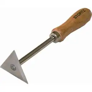

I'ld be scraping it off with a paint scraper:
One of these ones:
Paint scraper
Then sanding it down once the bulk was gone, (save gumming up a ton of sand paper)
