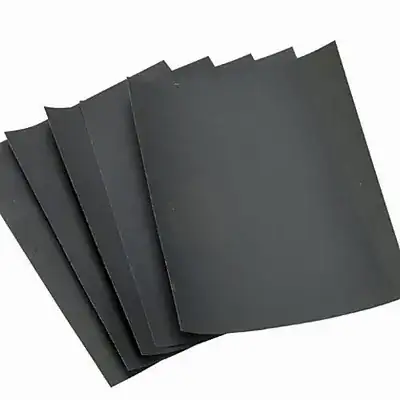

With some coarse sand paper 100/200 grit lightly loosen scratch the affected area.(lightly no need to apply great force)
Then use water sand paper 300-600grit to prepare the surface or to repair it after coats. You don't need to use it with water, using it dry is OK but will not last long. Normal paper is fine, as long as its fine.

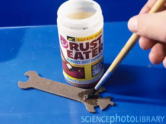

Get some corrosion remover (be careful as this is acid and can bleach your clothes, burn your skin and/or damage other surface) so best to this out side. Usually it takes 2 to 4 hours for the rust to be removed. The higher the concentrated the acid is the faster it will work. It will also bubble and smell weird, like rotten eggs in some cases. SO again keep it outside.
Now a common mistake is to clean it with water. Do not do that. Do not clean it at all just let it evaporate and dry.
