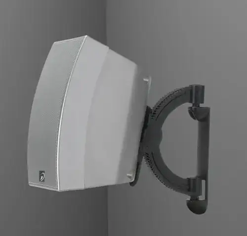

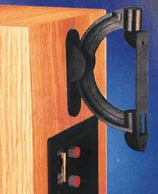

If you check out a home theater/audio site like Parts Express, you'll find oodles of different ways to wall mount a speaker.
For heavier speakers, I've used these guys in the past with excellent results. I think they're rated for 50lbs each. Plenty of adjustability and easy installation. I used heavy-duty drywall anchors to mount mine.

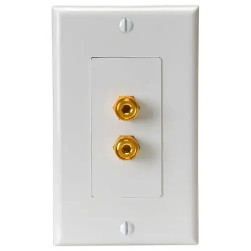

Add some in-wall speaker wire and some wall plates with binding posts, and you've got a nice, clean install.
