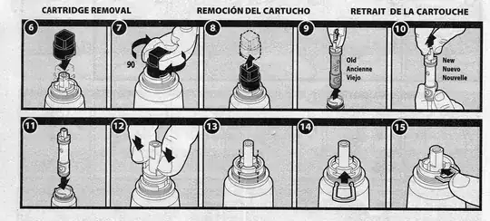

I have a single-lever Moen kitchen faucet that's 12 yrs old and I'm trying to replace the original cartridge. Moen sent a replacement cartridge (1225 B), that includes a removal tool. I've removed everything that is supposed to come apart up to this point, including the retaining clip that holds the cartridge in. The instructions at this point look like this:
instructions
The cartridge is completely circular, nothing keyed. It has O rings top and bottom to seal it. The removal tool is a plastic cap that fits around some wings in the top of the cartridge. You are supposed to use it to twist the body of the old cartridge. The only obvious purpose for this would be to sheer any built-up scale that might be stuck in the various openings, or just to generally loosen the body.

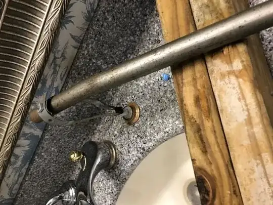

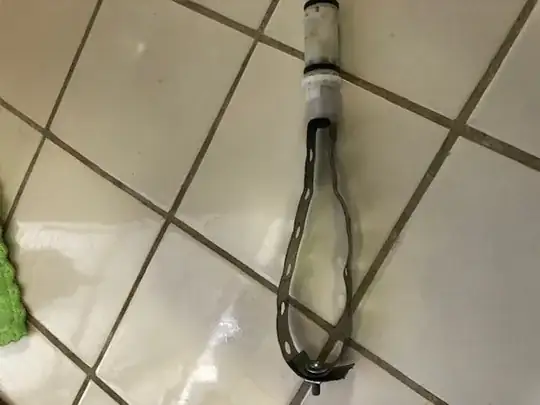

I am 82 years old (also a retired engineer) and I did not feel like getting under the sink. I then tried to attack it from the top. I fashioned a loop out of some old pipe strap I had and I was able to attach the loop to the top of the cartridge with the screw that is used to attach the top extension to the cartridge. I then fashioned a lever arrangement using a block of wood and the lever that goes on my floor jack. See the attached photos. With this arrangement, the cartridge just popped out with very little effort.
Here is a photo of the Pipe Strap loop that I attached to the top of the cartridge. This photo shows the cartridge after extraction.
This photo shows the arrangement of the lever with the cartridge still in the housing.

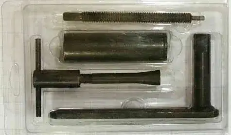

There is a cartridge removal tool you can use, I have never failed to get a cartridge out when resorting to it:
You can often borrow or rent this tool from a reputable plumbing shop (note importance of "plumbing shop", don't even waste your time at the big-box stores). There are other tools you will see, but they do not work as well as the one pictured.
