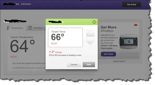

Some of the more advanced thermostats will track how often they are running. I have a Filtrete Wifi-Enabled Progammable Thermostat. It gives you a per-day total of how often the heat and A/C are run. You can also download an hour-by-hour export of the usage in CSV format.
I am in no way affiliated with this company. It is simply a product I have installed at home
It also gives you an idea, for a given temperature change, what the % change in heating cost will be:
Web Portal
