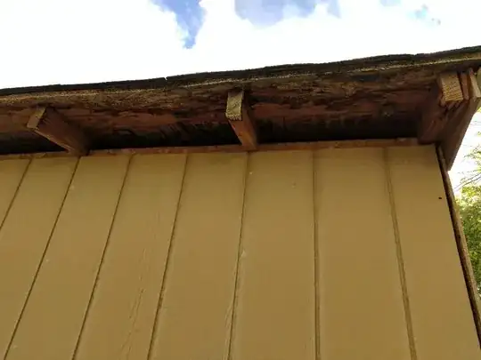

I have a nice shed in the backyard but every year wasp nests reappear in there. the shed has these 2x4 sized gaps between the roof and the side walls on the sides of the shed.
I saw a recommendation of using screen mesh, but what should I use to adhere the screen mesh to the shed?
My Shed with the gap at the top

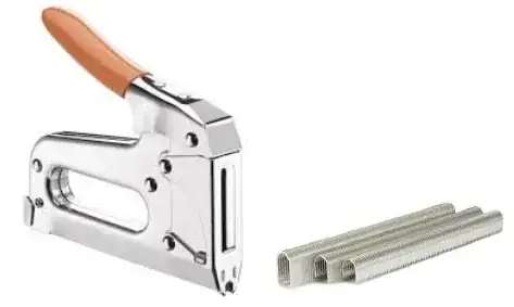

Another type of staple is applied using a staple gun. These can be purchased fairly inexpensive and the staple gun for the type of staples may look something like below. The staples best to use for this application would have rounded tops and have legs 9/16 inch in length. Sometimes a staple gun like these will not sink the staple fully and if this happens just tap it in the rest of the way with a hammer.

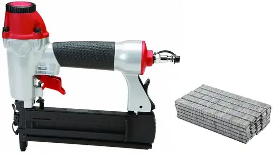

The third choice is to use a pneumatic brad nailer that is able to use staples. These are great because they shoot the staples in quickly and with enough force that they will be sunk way in. One slight disadvantage with many brad nailers with staples is that the staples are narrow and the nose of the gun does not typically have a guide to line up the staple over the wire of the mesh. So until you get the eye for it you may get some staples that do not bridge across the wires of the mesh.

Cut some 1x4's to fit between the rafters to block off the inside. Caulk around the edges to seal. You could paint the exposed wood a light (haint) blue like they paint porch ceilings here in the South. If you need the ventilation I would use a wire mesh over some type of screen. If it was my shed I would put a fascia board, drip edge, and soffit to finish it out.
