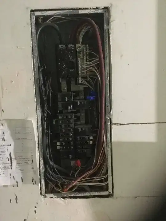

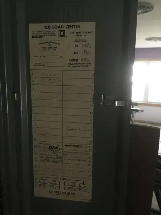

Based on feedback, further research and opening up my panel box. I'm thinking I'll consider not replacing the panel as i have a 200 30/42 box, but several of these tandem breakers are not in proper slots so I can fix that while ripping out all the AL wire and putting in new breakers and CU- I may do away with most of them as they're unneeded if i do the subpanel. I still think a sub panel is a good idea given all the big stuff is centralized - even though that means a flipped breaker would be under the house...
New question, last time i was in the box replacing a breaker that was shooting sparks into the house i thought my main lines were copper, they clearly are not. an electrician friend thinks they look fine, but should i consider a CU replacement all the way to the meter?
on the left is my trial/error breaker description, on the right is a hole patch from previous owner, not sure what the reason was

What am I overlooking? See the two large wires landed on the neutral lug and dissimilar metals to boot? That is illegal, a recipe for disaster, and a lost neutral can do far more damage than a lost hot. If the stranded Cu cable is your wire to your grounding electrode, that should go to your ground bus. If you absolutely need both wires to land there, then get the correct lug for this, which has voids for 2 wires.

It sounds like you prefer running 6 AWG wire. Paralleling is absolutely not allowed, you cannot run two #6's for 100A instead of one #1Al or #3Cu. If you want to keep your heavy-wire runs to a minimum, don't be bashful about putting the subpanel right next to the main panel. That is completely kosher.
For a short run, I'd be inclined to use copper (damn the dissimilar metals) because it will flex easier and be less likely to unclip the breaker.
