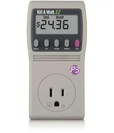

Without a doubt, it is the Kill-A-Watt meter. You want to measure Watts. And also Watt-hours.
Here is what they look like:
They are available from many vendors. Worth every penny.
Every brand offers both instantaneous use, but also cumulative and max.
Since most work the same, I suggest you shop around, assure yourself they all do about the same thing, then look at prices and speed of delivery to make your decision
