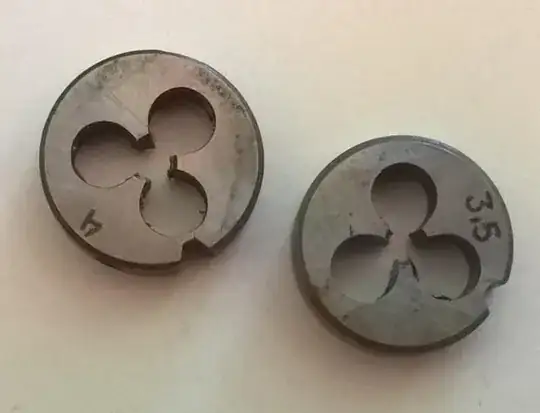

I have recently found in a box these two tools:
Tool Set 1
Tool 2
I do not have any knowledge on whether these tools are for wood or metal.

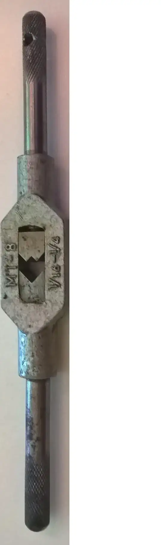

The second tool can be winded and unwinded in order to form some kind of tooth bite like shape to a material.

The top tools appear to be dies - used for cutting screw threads on rods. The lower tool appears to be a tap wrench (a tap is a tool a little like a drill bit, but used for cutting threads inside a hole). The "winding and unwinding" action is to allow it to clamp to the tap; the wrench is then used to turn the tap in the hole. The dies would also have had a wrench or handle with which to grip and turn them around the workpiece.
They are for use on metal.
See Wikipedia- Tap and die for more detail.
