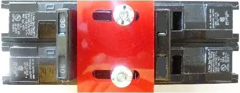

For permanent work, obviously, I'd put in a proper interlock. This is not as big a deal as it sounds. I would start by installing a small** sub-panel right next to the main panel. This would have two "main breakers" in positions 1-4, with an interlock between them (rather simple affair). One would feed from the main panel, the other from the genny. Then I would decide which circuits I would ever want to light from the generator, and move those circuits to the subpanel. The original main panel stays mains-only.
enter image description here src
