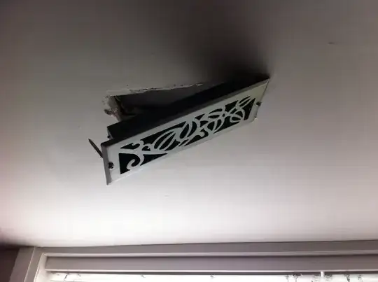

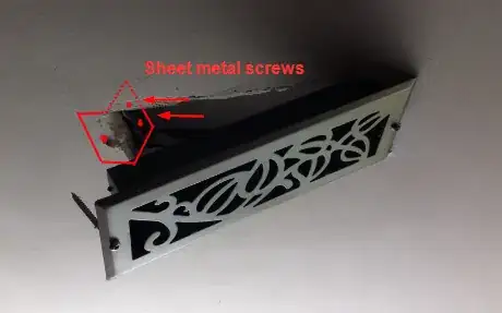

Screws that normally fix the vent in place can't do their job anymore. The drywall has crumbled to the point that the tapped hole for the screw lacks a boundary with the duct. (Picture attached.)
Perhaps:
  • The cutout for the original vent larger than necessary, forcing the screws to be closer to the duct than is optimal?
  • The original installation should have used some sort of plug so that the threads of the screw didn't compromise the integrity of the drywall so easily?
How would you:
  1. go about fixing this?
  2. prevent this from happening in future installations?
The issue, in an image:

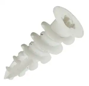

My default fix would be just to put in some type of anchor. Given the damage and the fact this is on a ceiling, I'd be inclined to use a screw-in type anchor, because they hold on to a larger area and would deal better with some damage.

If this is a heating duct, place a piece of sheet metal on the other side of the drywall and use a self-drilling screw to reattach the cover. If this is just a cover over a ventilation hole to the next floor (somewhat common in older buildings), you can safely use a piece of wood instead.
