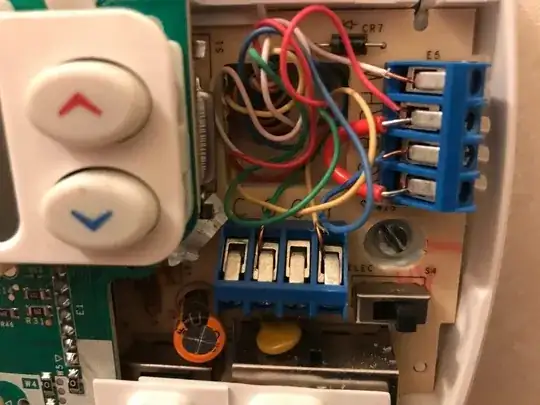

I noticed where the wires run to the thermostat it has a extra wire (orange) not in use.
thermostat wiring

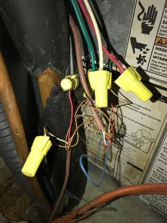

I then checked where the furnace to verify the same wire is not attached to nothing and it is not.
furnace wiring
If I am looking at it correctly I can connect the extra wire orange to the to the orange wire from the furnace which is not connect to anything (which if I am reading it right is the c wire) This would work correct? I am new at this and do not want to mess anything up.

It's a little unclear exactly what you're asking, but it sounds like you're on the right track. If the orange wire is unused (unconnected at both ends), you can use it as a C wire. Connect the one end to the thermostat's C terminal. Then connect the other end to the C terminal in the furnace.
If the furnace does not have a C terminal, please see this answer for help figuring out where to connect the wire.
According to the schematic, the grey wire should be C.
