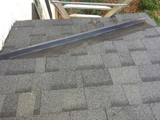

That being said, if you have to deal with the tree as is, the best solution would be to shorten the gutter by either cutting it and installing a new end cap or replacing that section of gutter with a shorter one. You will want to install a diverter (also called a shield) on the roof. This is simply an "L" shaped piece of metal. One leg of the "L" will slide under the shingles and the other will stick up. You will want to install this at an angle to kick the water from the edge of the roof over to the shortened gutter. Be sure not to allow debris to build up, but given the proximity of that tree, you are probably already cleaning you gutters very frequently. Something like this photo.
