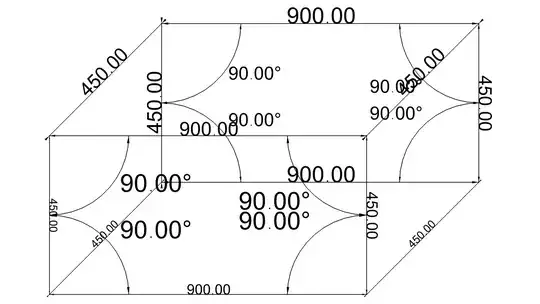

I've got a glass box that measures 900mm x 450mm x 450mm.
The width of the glass is about 6mm thick.

glass box schematic diagram
