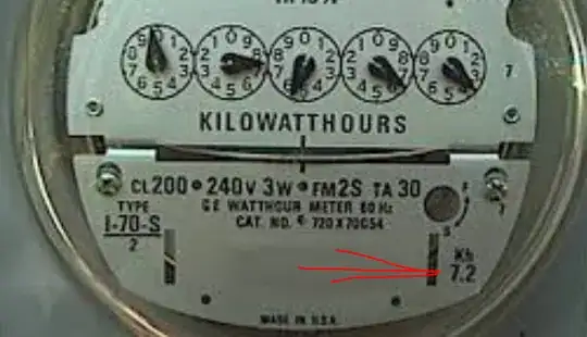

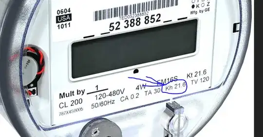

First, look for a figure somewhere on your electric meter called Kh. 7.2 is a common number, so you'd see a marking like 7.2 Kh or perhaps a different number. **
Take the Kh number and multiply it by 3600. You can call this number Ks. You might as well write this number on the meter, you'll be using it a lot. ***

** gory details: Kh is the number of watt-hours per revolution. A watt-hour is 1 watt for 1 hour. *If you had only a 1-watt LED nightlight burning, it would take Kh hours to turn.*
*** gory details: multiplying Kh by 3600 gives the number of watt-seconds per revolution, since there are 3600 seconds in an hour. By the way, for a 7.2Kh meter, this number will be 25920.

***** gory details: another example picture.
