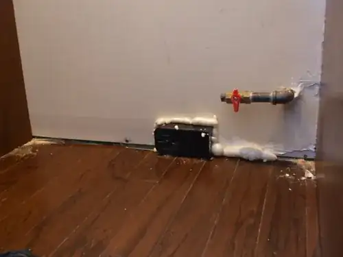

I finally sprayed some insect killer behind the stove, and that greatly reduced the number of ants. Today I pulled the stove out to see what it looked like back there and found the following (see image). I'm noticing a large space between the hardwood flooring and the drywall - is this normal? Should I fill it with spray foam? If so, is spray foam enough to prevent further insects from finding their way in (assuming the initial round of spray foam wasn't sufficient), or should I deal with ants a different way?
If I should spray, what would be an appropriate product to use?

Killing the ants is one thing, and the comments from others are good. However, you need to fix the root cause of the problem, which is hole that you can see daylight from. Spray foam will only deter them for a while. You should NEVER be able to see daylight through a wall from the inside of a home. I would take a good look outside and see how much of a gap existed before the foamed it. You may have to remove the siding to see everything, but I suspect the exterior wall may need to be patched.

The gap is not unusual. You could put spray foam there, but it will only have a negligible affect. I've had ants come in through an electrical outlet before. Any tiny opening is sufficient for their single-file "column" to come marching through. Hurrah! Hurrah!
The best thing to do is to apply a bait/poison like Amdro along the base of the exterior wall and use a few ant bait stations made for interior use in a few places in the kitchen. If the ones that you can get at the grocery or home improvement store don't do the trick then you can get better ones from your local pest control store that caters to the DIY market.
The products available to a homeowner will be limited and regulated, but they are often effective. Always follow label instructions.

As for the dry wall not coming down to the floor, that is normally covered up by base boards. I'm assuming the builders figured the stove would cover it so there was no sense 'wasting money' installing a baseboard there.
This is why I would never hire someone who only does new construction. They don't take pride in their work, they only do enough so that the new homeowner doesn't complain.
To really fix this problem permanently, you are really going to have to "dig" into the wall. Which is why the builder just put in some spray foam. Otherwise they would have had to spend more money, without getting another dime from you.
It might be worthwhile to have someone, other than the builder, come over and look at it with you, even if you have to hire them yourself.
