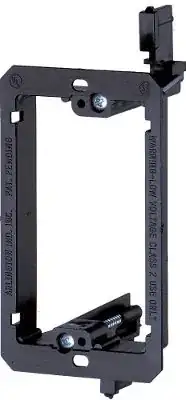

You ask for a box, as long as 120V does not go thru, then you can use a low voltage cut-in ring.
Lovo cut-in ring
These rings come in 1,2,3 and 4 gang or even round. You can use a 1 gang weatherproof cover with either 1 1/2 hub or 3 hubs. Or you can buy a blank plate and drill your own 7/8.
