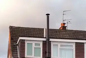

I have a freestanding wood burning stove that has a metal flue straight up through to the roof. The existing stone chimney with aerials is taller than the new flue (see pic).
Should there be an earthing system in place for the flue - more specifically to mitigate potential effects of a lightning strike?

A lightning protection system is a building wide system.
You don't just protect things individually.
The ridgeline of your house would get air terminals and then if the antenna and chimney are within the "zone of influence" (lightning protection term) they would be bonded to the system.
If your house is less than 50' tall and you are not in an extremely high strike area (central Florida), I wouldn't bother. Usually very tall barns are the only residential buildings that get lightning protection.
Good luck!

  • 20,870
