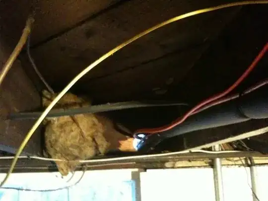

I noticed a good sized hole in an exterior wall that allows wires and things to go from my AC unit into my basement.
The problem is that the hole is a good deal larger than it needs to be and there is nothing sealing the hole, so I can see sunlight clearly through the hole.
What should I use to fill this hole in my wall preserving the important stuff going through the hole?
Click for full size
hole in the wooden exterior wall

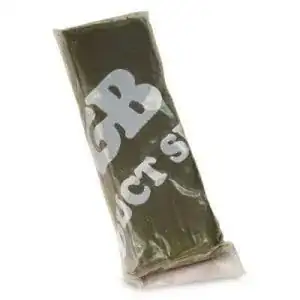

I would use Duct Seal
I'm surprised whoever installed the AC unit didn't use it, it's used all the time by Electricians and HVAC technicians.
It does not harden; so unlike foam, it can be easily removed and replaced if you have to add/remove wiring/plumbing.
