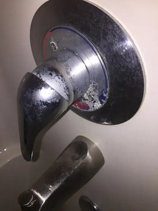

Built my house in 2005. We have a tankless hot water heater. It appears to be working fine. Plenty of hot water from other faucets.
Guest bathroom shower is all from original contractor install. Single-lever ball handle, American Standard - lift to start water flow, turn handle to adjust temperature.
About three weeks ago, I noticed that the water in the shower is either totally cold or too hot. I can't get a "warm" temperature. If it's too hot, for example, and I "nudge" the lever to the right, the water becomes completely cold. And vice versa.
The water pressure, regardless of temperature, seems fine. I do not notice a drop in pressure whether the temp is all cold or all hot.
So, before I call a plumber, I am wondering if this is possibly the sign of a bad cartridge, which I think I can replace on my own and skip the repair bill. However, I really don't want to waste my time disassembling the faucet if a bad cartridge could not be causing this problem.
Would appreciate your thoughts. Thank you!

Yes a bad cartridge can be the issue.
I speak from experience, you may want to forgo buying said cartridge until you take it apart and inspect the valve and parts.
Often times pieces of plastic, rock, minerals, bad sweat 'balls' and other contaminants can get in there and bind the mixing valve in the cartridge.
Also, if you find it is cracked, warped, or otherwise damaged, you might want to get the replacement from a reputable parts supplier. I was stunned to see that Home Depot was selling all plastic and Kohler OEM part was 90% metal (OEM, pronounced as separate letters, is short for "original equipment manufacturer").
I tried the Home Depot part to no avail. The OEM part worked and continued working at least for 8 years until I sold the place.

I think this is very likely a problem in the thermostatic mixing valve of the shower, but to definitively rule out your tankless water heater as the problem do the following.
When the water stream in the shower goes completely cold after your making a tiny adjustment to less hot, leave the handle alone and immediately check or have some else check to see if the tankless heater has turned off. If it has, then you know it's the tankless heater. Tankless water heaters require a minimum flow to stay on.
Our tankless heater became erratic when I installed low flow shower heads. When I removed the flow restrictors in the shower heads (increasing the flow rate) the heater performed reliably.
One way to test if the shower valve or the tankless heater is the source of the erratic behavior is to set the lavatory faucet to run a medium low level of hot water and see if this affects the delivery of hot water from the shower. When I realized that our problem was our tankless heater shutting off, I had the user of the bathroom where the problem was worst run hot water from the lavatory faucet during showering. This kept the heater on, but of course this is rather wasteful. Once I removed the flow restrictors in the shower heads we of course discontinued running the lavatory faucet.
Our Bosch tankless heater has been in service 13 years and is a basic discontinued model Bosch which has entirely mechanical controls. It has no digital temperature control, and does not require a source of electric power. It is possible that a proper adjustment of the gas flow 'slider' and the temperature knob would allow the heater to stay on with the low flow restrictors in the shower heads.
Jim Stewart
  • 22,784
The cartridge is part of the mixing valve. The cartridge is the replaceable part of the mixing valve which is accessible without tearing into the wall. But your findings indicate to me that the tankless heater is shutting off when you reduce the amount of hot water.
What is the model of the heater? What do you have the output temperature set at? If you lower the output temperature of the water heater, this will cause an increase in flow rate by thermostatic mixing valves and the water heater may stay on.
Two possibilities come to mind:
(1) for some reason the tankless heater is requiring more flow to stay on than it did before
(2) the shower heads have plugged up some and they are drawing less water than before, so much less that it is not enough to keep the water heater on.
Does your shower mixing valve have a variable flow rate or is it always on a certain flow and only the temperature is variable?
