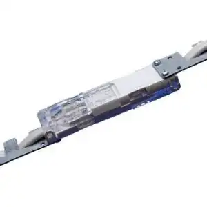

Not exactly an answer, but these are rated for hidden splices in most locales:
http://www.idealindustries.com/prodDetail.do?prodId=spliceline&div=0&l1=push-in
Or these:
http://www.homedepot.com/buy/electrical/electrical-tools-accessories/tyco-electronics/romex-splice-kit-2-wire-1clam-48760.html
