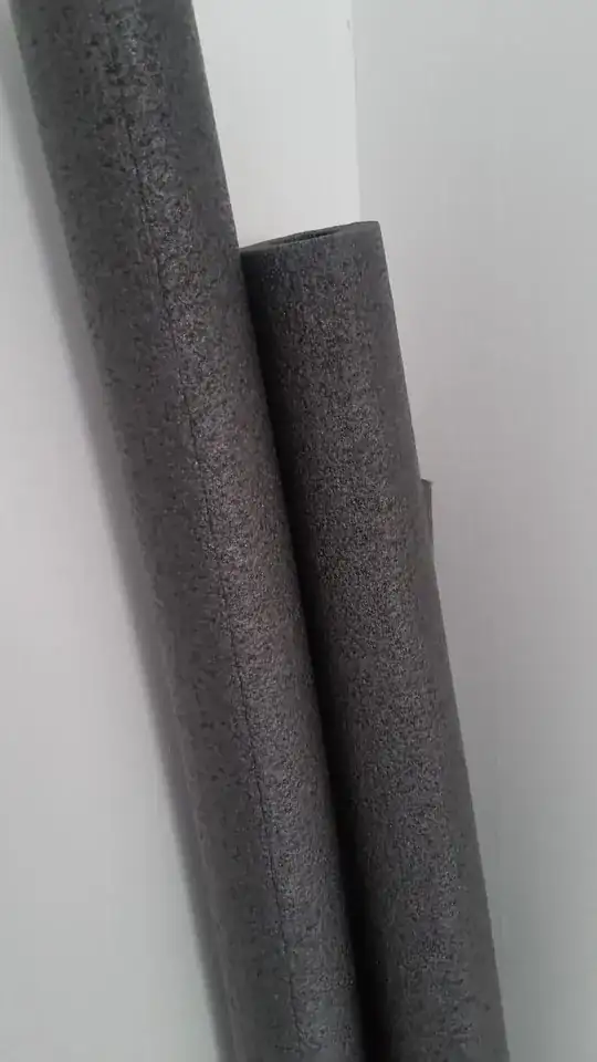

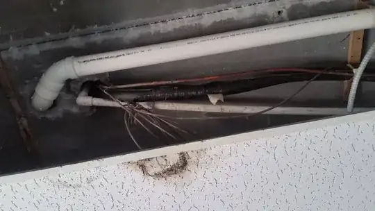

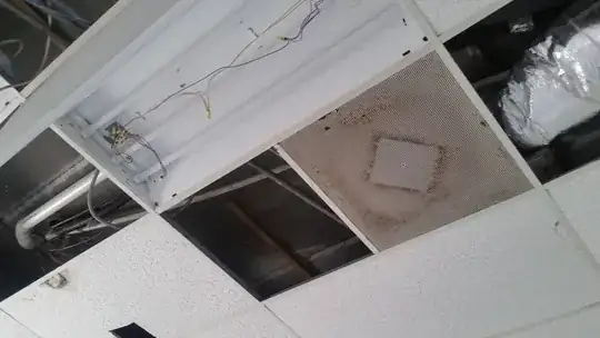

A sweaty condensation drain line is dripping and causing mold in a ceiling panel:
The condensation drain pipe is lengthy and spans two rooms:
QUESTION
Is insulating the pipe an effective means to counter this drip / mold problem? If you have successfully solved this problem please state this in your response and include details / context. Thank you

Yes. Isolating the pipe from moist air has been the common fix for decades.
Not sure where you live but in humid climates it is standard practice to insulate condensate drain lines for that very reason.
