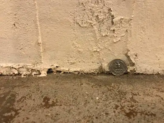

After a particularly strong rainfall (every ~3 years), water seeps into my partially finished basement from small gaps in the intersection between the wall and floor.
Areas where the water seeps in
The amount of water is significant. Last time (a couple of weeks ago), it was about 6 gallons.

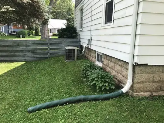

The side of the house with the issue has good grading (by my assessment), 8 ft. gutter extensions, and is a side of the house that the roof doesn't slope onto.
Outside of the house

Close up of one of the openings
The gaps are small, so I believe I'd have to chisel out a larger gap to install the hydraulic cement properly.
