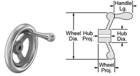

If you want a nice clean solution then you want to check out a selection of hand wheels. Some types even have a crank built into them. Many even have a provision for a set screw to lock it to the shaft to which they mount. There are styles made of various types of materials. Those shown here are made of aluminum.
