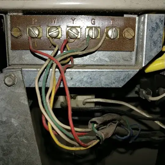

I bought a new thermostat that needs the c wire. Old thermostat wasnt using the blue c and was stuffed back in the wall. Come to find out the blue c wire is not connected to the furnace. Trying to connect the blue c wire to my furnace. As you can see all the wires are connect except the blue c which is wrapped at the bottom of the picture.

Found solution. Just connected C blue wire to the T terminal on the old furnace.
