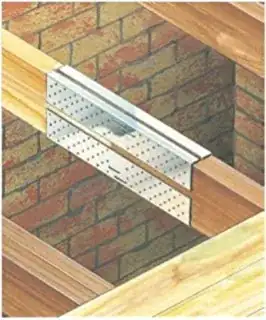

For structural applications involving vertical shear loads - like splicing joists - in buildings, you'd typically use something very different to that illustrated above. E.g. a "splice plate" or "nail plate".

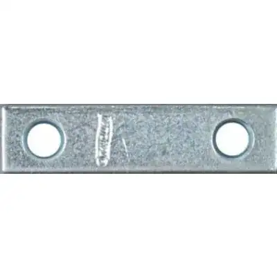

In the USA, this has been known as a mending plate for as long as I can recall. I might have learned about the terminology in shop class, it's that old:
mending plate
A quick google search using those terms results in far too many links to list. Stainless steel, brass, zinc plated steel, probably even copper, although the latter would be a terminal jumper rather than a mending plate. Prices from under a dollar to triple that or more.

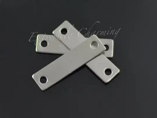

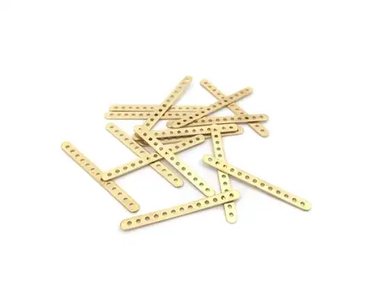

It's not going to have a standard name. It performs different roles in different applications, where it receives semantic names. It's just a bar or strap that's bored for fasteners.
For example, here it's a bracelet blank:
And here it's a separator bar:

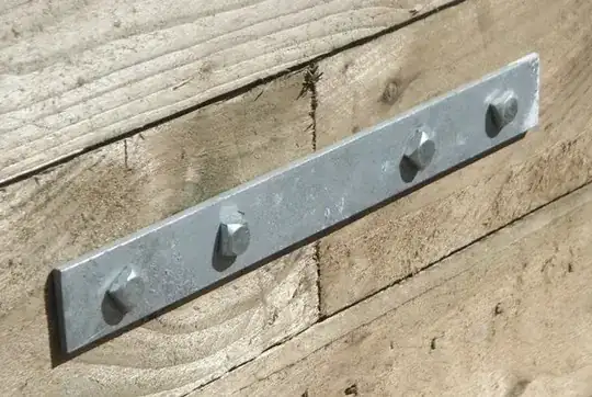

I have seen these in the big box stores the are for generic timber frame connections, this is a small sample, not exactly what I seen but gets the idea across. It is 5"X 1/12", the square holes will not matter. They are a help if you use carriage bolts
