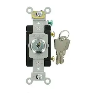

The outlets in the workshop have their own 20A breaker switch. Lights are on another 15A. I thought of installing a keyed switch between the breaker and the rest of the outlets. Something like this:
Which is rated for 20A.
  1. Am I overlooking a better solution?
  2. Would installing such a switch, as long as it's properly rated for the load it's going to carry, have any unintended consequences?

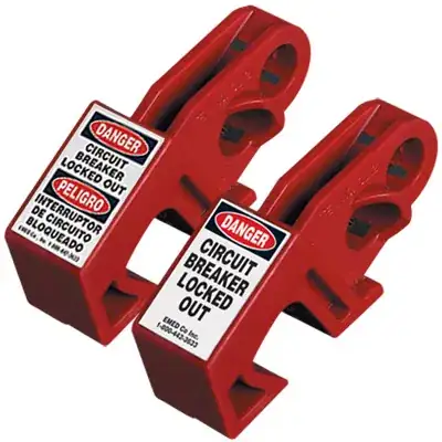

I would not consider this solution inexpensive, but not bad compared to hospital bills. There are devices known as circuit breaker lockouts:
Universal Breaker Lockout
A number of sources exist on the internet, with varying prices starting from slightly under US$20. I used the search terms "universal circuit breaker lockout" to find representative samples.
The more economical versions I've found require a user-purchased padlock to properly secure the device, as well as a mounting screw to provide the necessary attachment.
An added advantage of this approach would mean no wiring modifications and the associated labor.
One could combine this lockout with a phone-capable electronic padlock and not worry about having the keys at hand.
