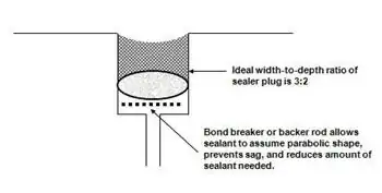

A quick Google search for concrete joint sealer turns up loads of products, most of which seem to be Polyurethane Epoxy. I haven't done enough of this type of work to recommend one brand over another, though I'm sure an employee of your local hardware store will have an opinion.
When sealing the joint, you'll want to pay attention to the depth to width ratio. The manufacturer of the product you've chosen should recommend the proper ratio for the product, which will usually be between 1:2 and 3:2.
You can use foam "backer rod" or "filler rope", to achieve the proper depth to width ratio.
