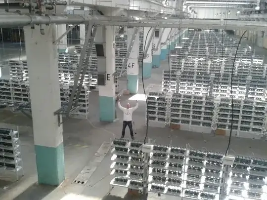

I'm trying to start a business in my house: Cryptomining. Essentially, I will be buying many big power-hungry computers which will print money out of thin air. It's a very lucrative business.
6000+ amperes of powa!!!
(source: coindesk.com)
