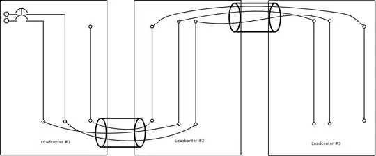

That said, let's move on to more specific points to address, starting at the panel. You'll want the biggest panel you can get in terms of slots (Siemens makes 54 slot units, and Square D and Eaton both make 60slot panels -- if you're really in "cost is no object" land, Square D also makes an 84 slot NQ but that's squarely in commercial panelboard territory as it requires a 20" wide box). In fact, for a new house, I'd recommend two of those 54 or 60 slot panels, daisy-chained using subfeed lugs, as depicted below -- that way, double-stuff breakers will stay a thing of the past.
daisy-chained loadcenters using subfeed lugs
