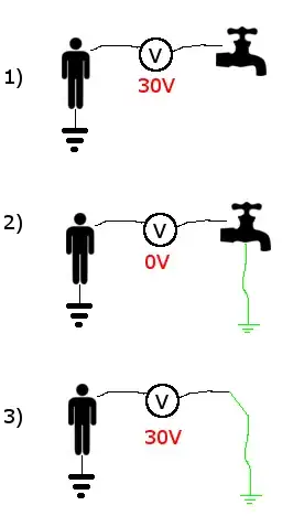

I then connected a new ground cable from the breaker panel's earth bar to the faucet. Using a volt meter I got these 3 readouts:
3 measurements
1) I'm standing on the bathroom floor, and hold a Volt Meter's pin1 in my left hand, while I hold pin2 against the faucet
2) Same situation, only this time I connected the new ground cable to the faucet
3) This time I hold pin2 directly against the ground cable.
I have no idea what's going on. How can my ground cable have a voltage of 30V, when I'm measuring between the bathroom floor and the ground cable (20m / 65feet) to the earth rod?
Update 7 months later: This bathroom has been fully renovated now. I have a suspicion about what was going on initially. Under my feet, inside the flooring there was a metal tube which held insulated electricity wires. At the endpoint of that metal tube was a light switch 1 floor underneath the bathroom, and I think it probably was a faulty device leaking current (a bad light switch can act as a sort of capacitor I think). (= fault 1) The metal tube must have been connected in some way to the light switch. (= fault 2) By standing directly above this metal tube I put myself at 30V potential, and while touching the bath faucet (which I believe is a natural ground in any house) I felt this.

DVMs (Digital Voltmeters) are not 100% reliable. Their resistance is so high (in theory they should read a fault as full line voltage) that they often misread ordinary capacitive coupling as relevant voltage.
Don't use yourself as a voltmeter. Hunt down a testing device that successfully indicates the fault, e.g. a non-contact voltage tester, mechanical meter voltmeter, neon light tester, etc.
